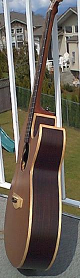

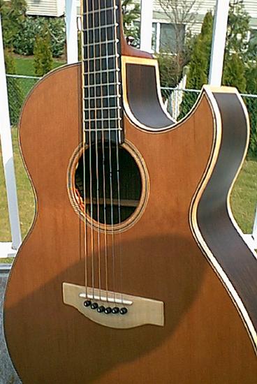

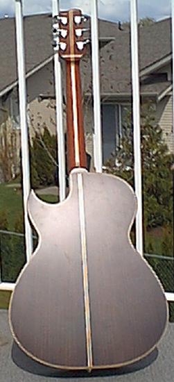

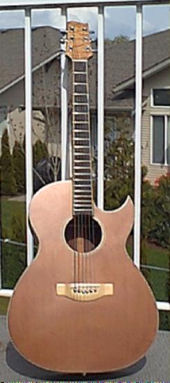

All right, here's mine.
So.... here are the stories behind the "1st"
was so eager to glue the back on that I did it outside the mold. (stupid) Now the neck block was not square to the centerline of the back. So, now I had to take the back off and re-set it. So, after much heat (with little water. stupid) I got the back off and had a 6-8" crack from the top (near the headstock) to the middle of the back, thank goodness it was along the grain line. I sure cryed when that happened and I wanted to trash the entire thing (Thank goodness for level headed wifes. She's the best). But cooler heads prevailed and the back was fixed (I can't even find the crack) and glued on.
Next, neck. I was so eager there also that I sanded through to the truss rod in 3 spots along the neck. Yikes, way to many to backstrap (although I tried, it looked awful) So I made a second neck, thinking I could use the fretboard at least, well, I didn't have enough heat (read knowlege or what the heck to do) that I ended up trying to saw off the neck from the fret board, Well you can guess how that went, so I made a new fretboard as well. I least I saved the truss rod .
Finaly I was so afraid to mess anything more up that I farmed out the finish. It was great and 1 month later I was ready to bolt on the neck, bridge and set it up. Well, I was bolting on the neck/gluing down the fb when I hear this "crack" as I'm tightening up the bolts. Well, I nearly popped the bottom portion of the heal off the neck, it was hanging by a sliver and the finish. I was using the new Cumpiano style bolts and I guess I torqued it up too much and snaped the heal. Well, I glued on the heal, drilled and installed a 1/2" maple dowel, filled the holes for the barrel bolts and used the screw in inserts instead. That worked (has been holding for 4 years now). I still have the crack in the finish and all the burn marks inside the body to remind me that it certainly isn't perfect actually there is a very distict hump at the bass side of the bridge to also remind me it isn't perfect. But I sure love the sound. That guitar has alowed me to make and sell 3 others, with 2 more on the horrizon (very near infact, just waiting for the deposits).
So there you have it, stories and all.

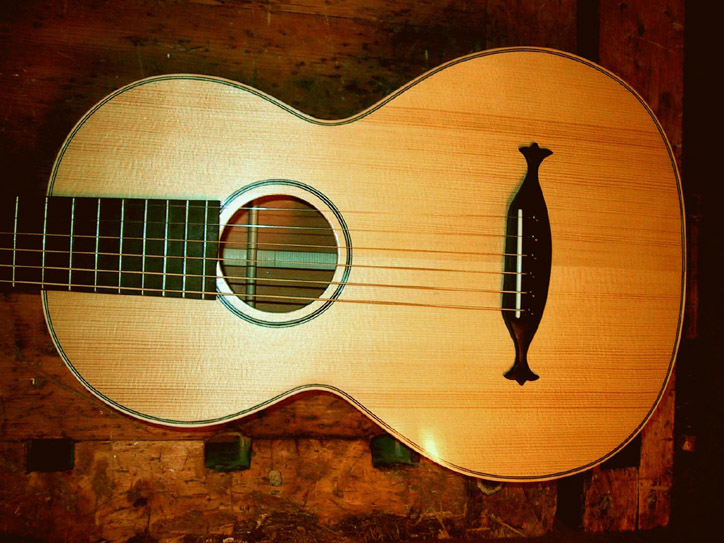

I only have this one picture of my first guitar from 2000. It is a parlor guitar modelled after a broken instrument that belonged to my wife's great grandfather. I made it with one hand plane, a couple of chisels, a home made purfling cutter, home made clamps and so on. Great learning experience!

Arnt,
That's a beauty, especially considering the limited tools you had. Probably like building might have been 200 years ago, no?

Hesh, the original guitar is still on the family farm, on the wall of my wife's grandfather's living room. He unfortunately tried to fix it after I had made this one, and did a "refinish" job. It is (used to be) a much prettier guitar than the copy I made; it has multi colored purflings, Brazilian rosewood back and sides (as far as I can tell), a French polish finish and so on. I think it is of German or Austrian origin, but I could not tell you how old it is. I know my wife's great grandfather got it around 1910 but it was not new then.

Arnt, that is one sweet guitar; and what a cool choice for your first effort! Is it ladder-braced?

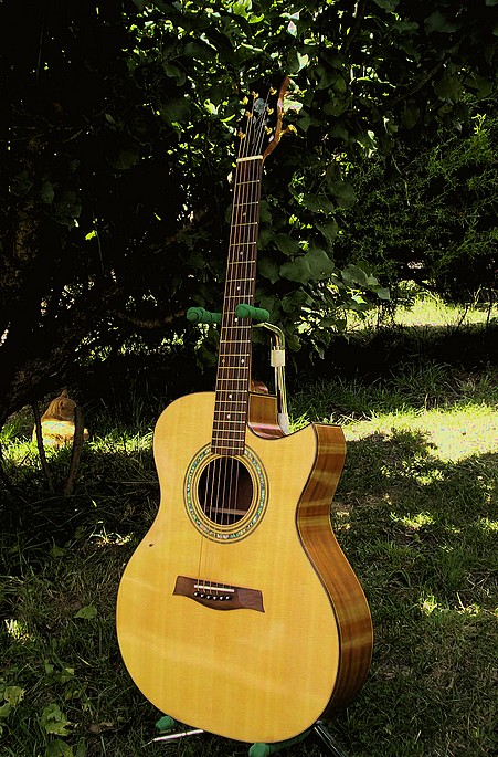

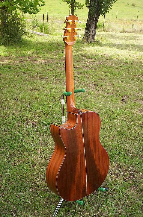

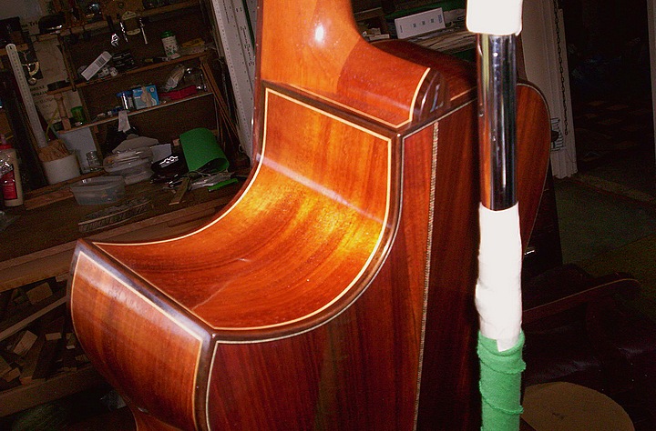

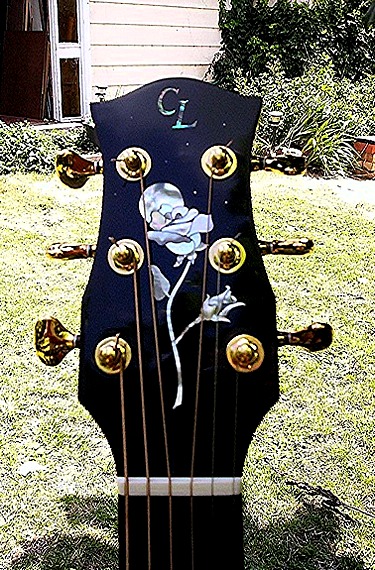

I have been playing it for a month now ,and it sounds/plays much better than it looks !!

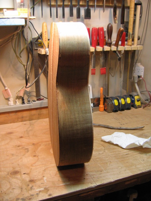

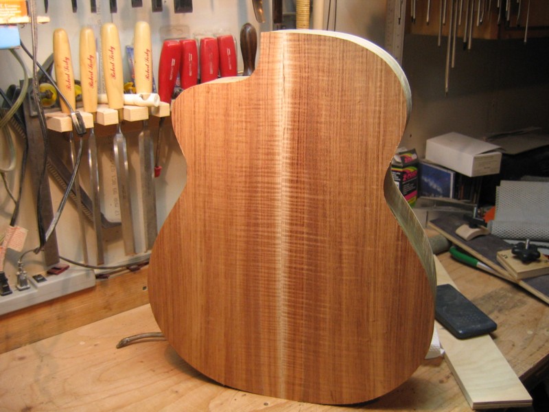

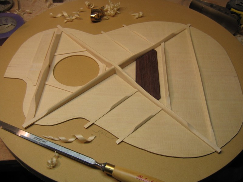

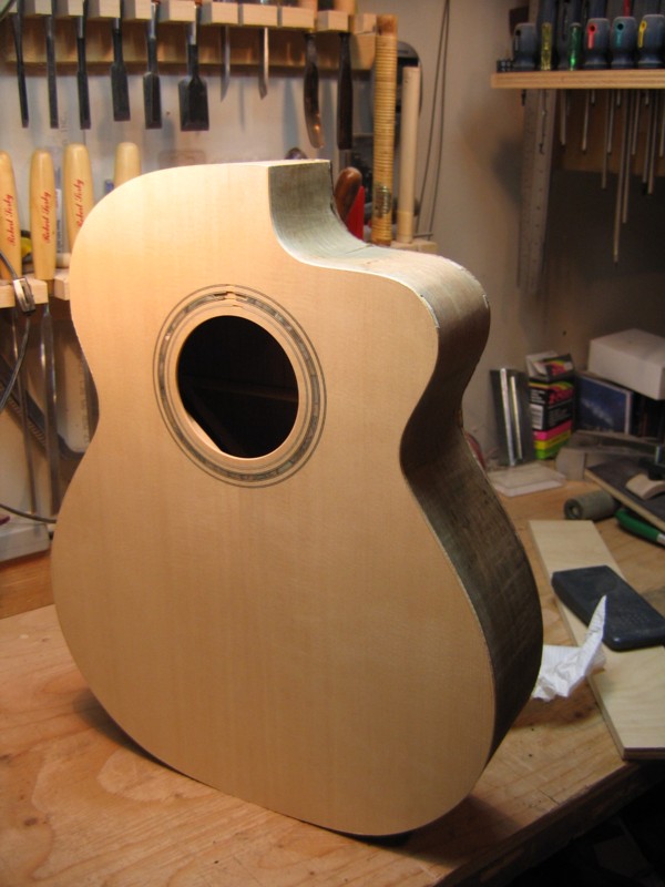

Here is my first, still in progress!
The top braced:
The x-braced back, attached to the rim:
The closed up box:
That's it so far, the neck is blocked out also.

Sweet looking Shane, very sweet

Hesh, thanks for the comments, yes the bridge is maple, the second guitar is identical, even the bridge is maple as well. Sounds realy nice with the maple, but I've never tested it against anything else so what do I know.

Dadburnit! I knew KiwiCraig would slip his in again. Love it!
PostPosted: Tue Mar 07, 2006 3:52 pm
Yep i'm again with ya Ron, i remember when KiwiCraig showed us the first time and thought Gees, where was this guy hidin', he ain't no rookie! lookin' at his guitar and yours BTW almost made me loose my glasses because the eyeballs wanted to come out of their socketts! nOW TELL ME THE TRUTH AND SAY YOU BOTH WERE LYING AND THESE WERE YOUR 100TH!
Shane, i see you made a lot of progress, your natural talent and overall skills are undeniable but you're probably lyin' too about this bein' your first!
